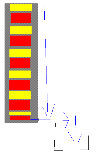

From this I gather you are not allowed to make something like this:
Maybe creative thinking would help. Using an elastic band, you could make a "brick launcher" :D

Yes, you are right. I'm am not allowed to build a dispenser like what you have drawn.
Thanks for your help, we have solved the problem by building an inclined narrrow block holder with a motorized wheel that dispenses the blocks.
