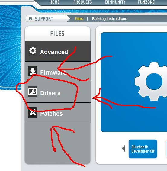

Perhaps you should check that you have the latest Lego Fantom driver, available at
http://us.mindstorms.lego.com/en-us/sup ... river.aspx
Re: Bluetooth troubles in NXT-G
Yeah none of this helps. Of course I have bluetooth turned on on the NXT brick and the drivers you linked me to are firmware updates for the brick it says.

zemata wrote:Yeah none of this helps. Of course I have bluetooth turned on on the NXT brick and the drivers you linked me to are firmware updates for the brick it says.

Ok guys thanks for the advice. Just popping in one last time to say it's working now. I can get into my brick wirelessly from NXT-G
. My problem was after I installed the latest drivers, I didn't try connecting from NXT-G, but I kept trying to connect from the brick!
