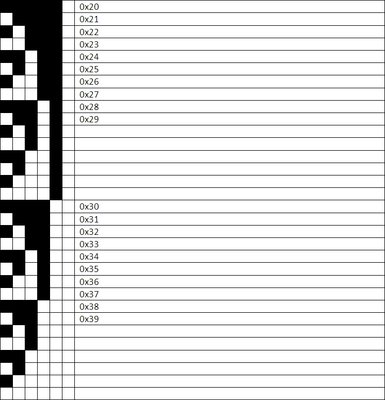

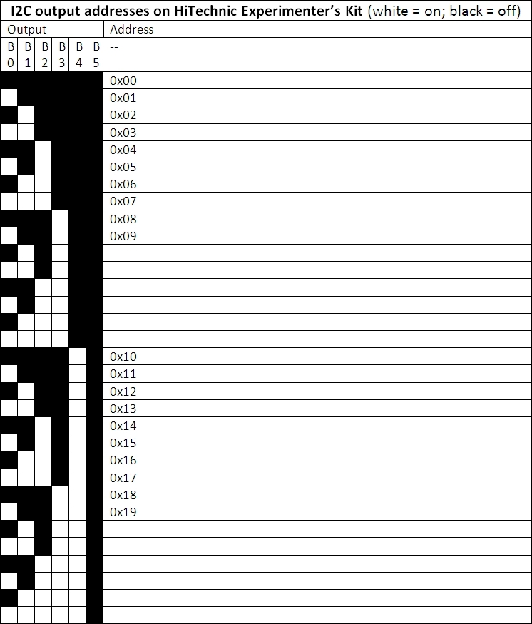

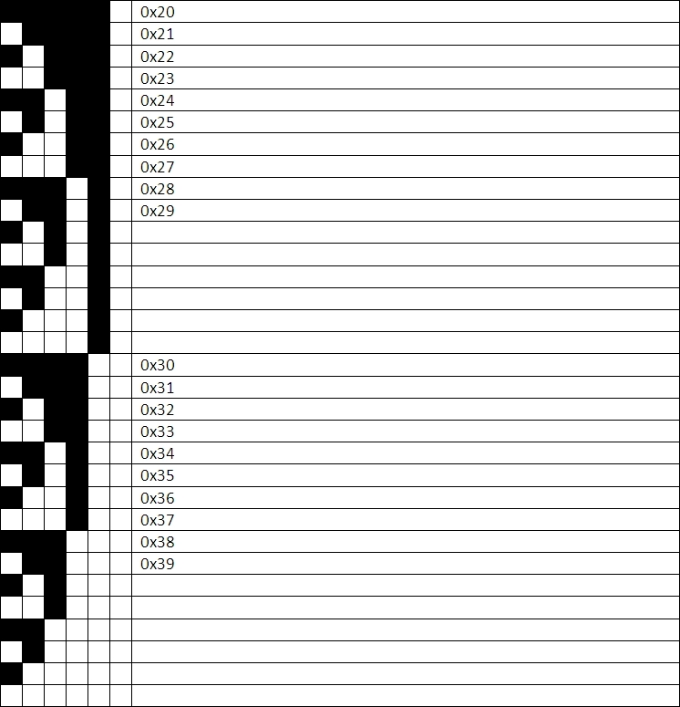

I recently got the HiTechnic Experimenter's Kit, and I've got it set up withsix LEDs connected to the output pins (B0 - B5) on a breadboard. i was trying to turn them on in different ways using one of the example programs, but I can't get some of the combinations, like turning the first four on, for example. So I wrote down all possible combinations, and tried to get them. Turns out I can't get 24 of them.
The attached images (they might also show up below, if everything works) show all the combinations I could think of, with the I2C addresses next to them, if I could find them. My question is (surprise surprise) if it's possible to achieve those other outputs and how?

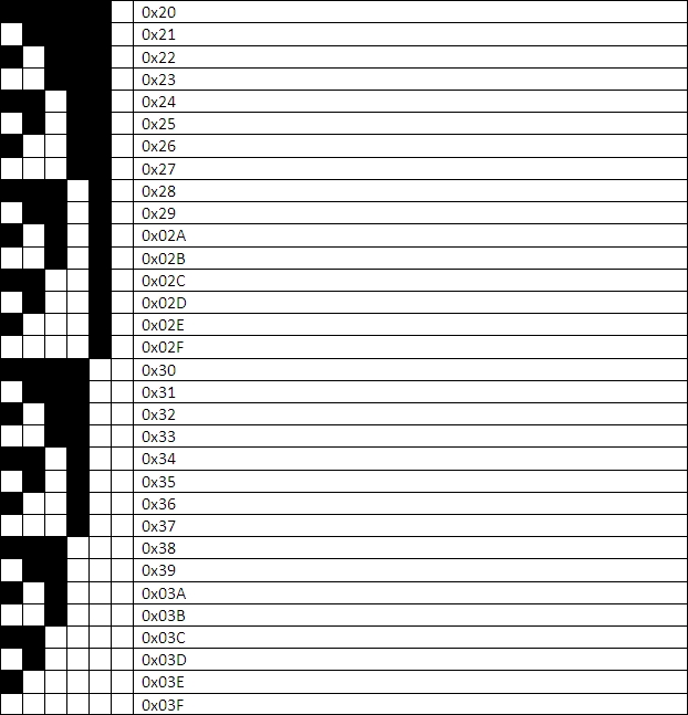

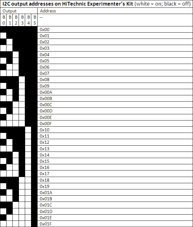

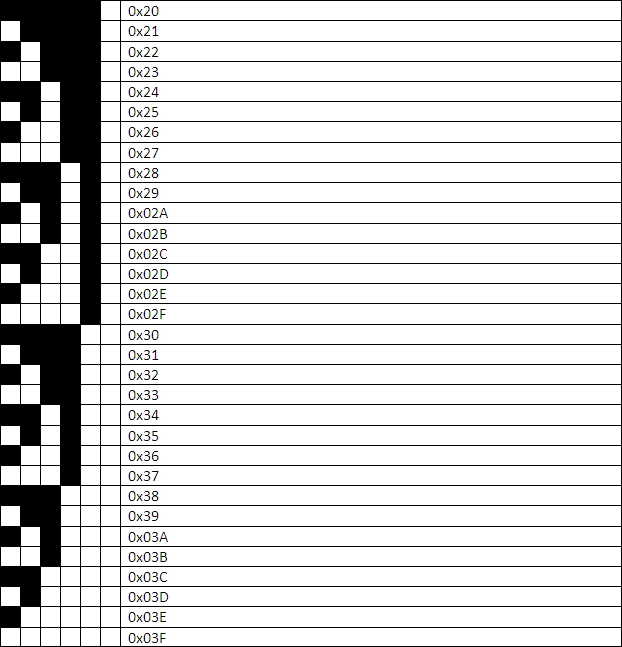

yep, that was the problem. Thank you! Address 0x00A, B, C, D, E, F got the first six, 0x01A, ..., F, got the second, 0x02A, ..., F got the third and 0x03A, ..., F got the last; they were even in order! I've got images of the new list attached below (can't paste the whole thing here because it's too long :/). If it's helpful for anyone, I can post a link to the full image.
