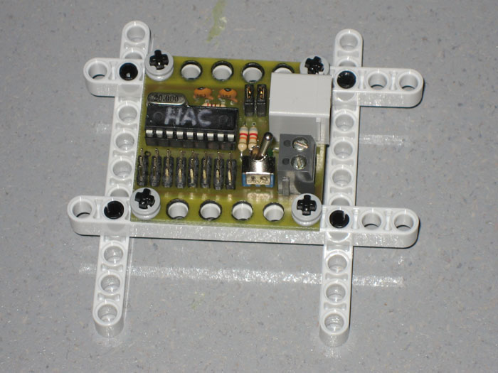

Hi there,
I'm a big fan of the Lego Mindstorms kit, and decided to make my own servo controller because the Mindsensors servocontroller is to expensive for my budget.
It works by using the I2C signal from the Lego brick, and the I2C write block from Mindsensors.
I can't select the servo speed, but I can adjust to speed by inserting a delay time in the program, so It's not as sophisticated as the Mindsensors servo controller, but it does the job... :D
I would like to hear what you think of it, so please take a look at it, on my website.
:arrow: http://www.hacsoftwarecompany.com/?proj ... _nxt_servo :arrow:
Many thanks !!

Nice sensor! What controller did you use to control the servos?

I used a PIC Microcontroller, type 16F819. This had it's own I2C communication, so it's easy to attach this to the Lego brick. And the PIC microcontroller also can produce a standard servo output signal. Not that difficult to make, and quite cheap. It cost me about 20 euro's in parts.
I see that your also from the Netherlands, so I'll post the same link to my site, but in the Dutch language for those who rather read in their own language... ;)

I must say that I'm a bit of a perfectionist, so I made a PCB for my project, but yours is great too. And as long as it works, it's cool in my book !

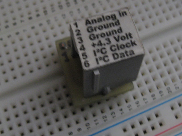

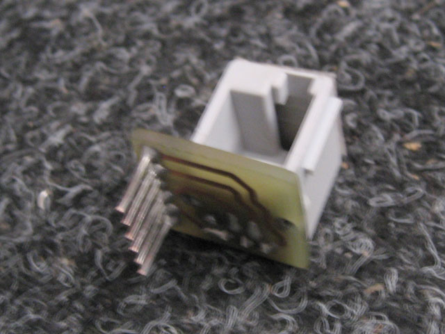

mattallen37 wrote: I want a breakout for the mindsensors NXT jacks.
I actualy made a breakout jack for the NXT. You can order the NXT jacks from Mindsensors.
Sorry, the photo's are a bit blurry... I dropped my camera and now it can't focus anymore :oops:
If you can't make PCB's, you can just solder wires to the jacks and put then into your breadboard.
Re: My selfmade servo controller
That is basically exactly what I mean/want. The only thing I might want different, is for the jack to be turned 90 degrees.
Yes, I know I can buy them from mindsensors, but I want a breakout (like yours), instead of soldering wires directly.
