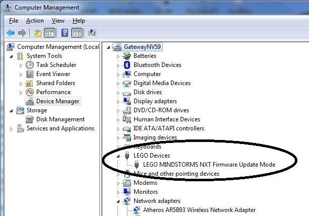

When in SAMBA mode the NXT should be listed as a LEGO MINDSTORMS NXT Firmware Update Mode device. See the screenshots below.

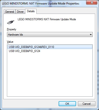

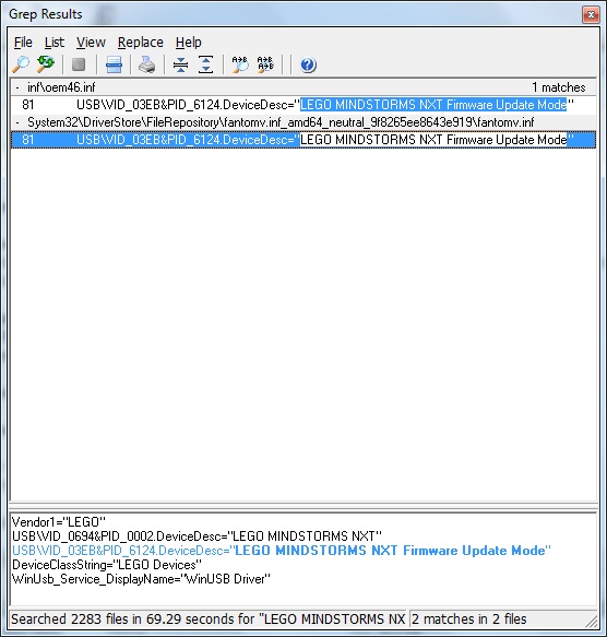

No other vendor should be using the 03EB vendor ID that belongs to ATMEL. And there should not be any other drivers installed on your system that match the combined 03EB vendor ID and 6124 device ID for the NXT in SAMBA mode. http://www.linux-usb.org/usb.ids lists the combined vendor and device ID as at91sam SAMBA bootloader. In device manager it should show up as using the winusb.sys driver. The connection to this driver should be specified for the 03EB vendor ID and 6124 device ID in the fantom.inf file that was installed on your system when you correctly installed the latest version of the Fantom drivers from the LEGO MINDSTORMS support page.

If you have confused your OS about what driver should be used for the NXT when it is in SAMBA mode then point it at the fantom.inf file on your system. It should configure it as a LEGO MINDSTORMS NXT Firmware Update Mode device using the winusb.sys driver.
