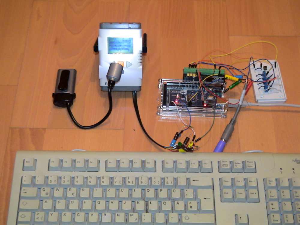

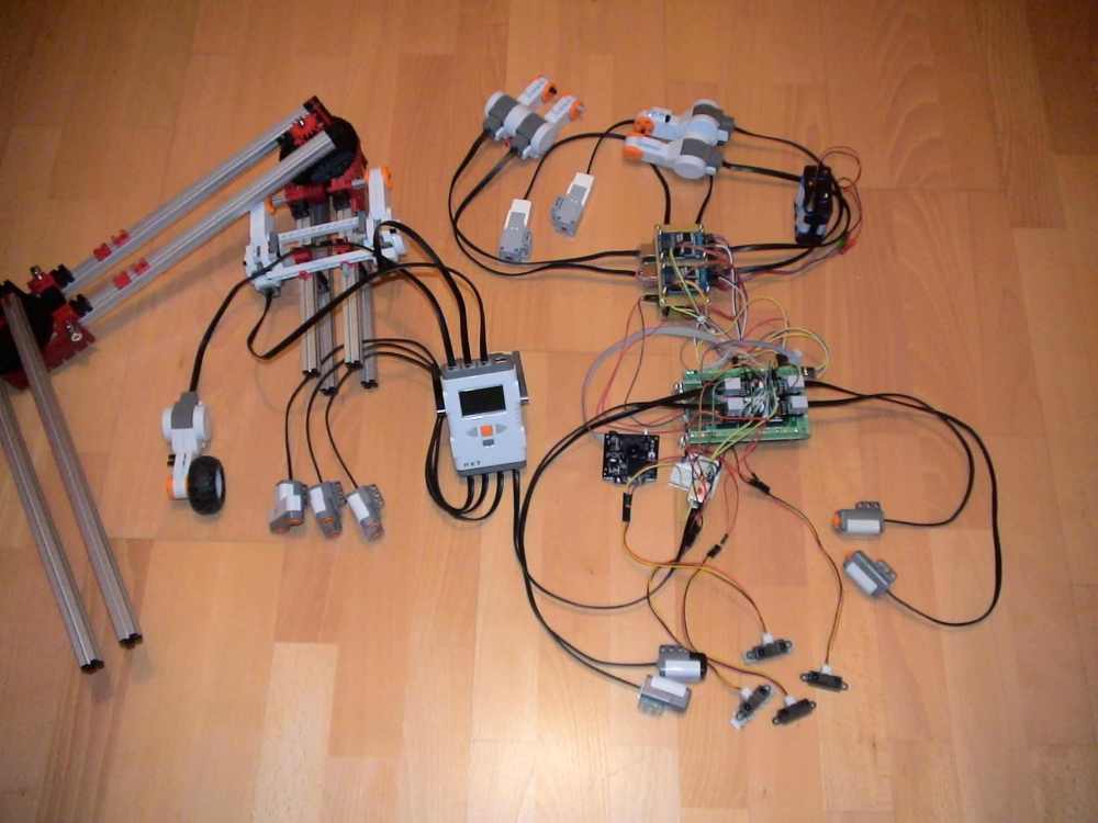

I did something quite similar for the NXT interfacing an Arduino Mega or Due,
adding simultaneously
up to 8 Lego encoder motors (8 for Arduino Mega - just 6 for Arduino Due),
up to 8 analog sensors (including original Lego Mindstorms sensors or even Lego I2C ultrasonic sensors ),
up to 16 digital touch sensors
and optionally even different devices and sensors like e.g., a PC keyboard or a PixyCam to my NXT :)
http://www.mindstormsforum.de/viewtopic.php?f=70&t=8302
http://www.mindstormsforum.de/viewtopic ... 700#p66006
Unfortunately I am not able to program the EV3 to do the same work being interfaced by I2C :(
intermediate test setup:<br />interfacing an original PC PS/2 keyboard plus 4 analog sensors plus 1 touch sensor by 1 Arduino Mega to 1 NXT brick
Arduino Due as a multi-I/O muxer to a Lego Mindstorms NXT<br />local on the NXT: 3 encoder motors plus 3 US sensors<br />remote on the Arduino Due muxer: 4 analog Lego sensors, <br />4 analog Sharp IR sensors, <br />6 encoder motors (Mega: 8), <br />a PixyCam, <br />plus (unfortunately not shown): additionally 16 touch sensors <br />plus optionally 1 PC keyboard attached to the Arduino board
a PixyCam,
