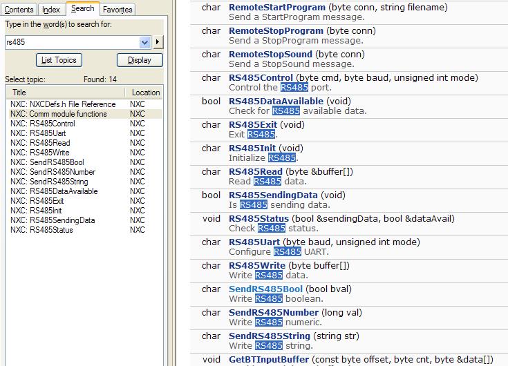

Please see the RS485 API functions in the NXC Guide and help files. The example files are not great, sadly, but they can be improved. The code posted above was written prior to the addition of the official API functions and they require the enhanced NBC/NXC firmware.
When you send a number or a bool the API functions (which are called functions or procedures - not "void") flatten the data to a string. This is not the same as calling NumToStr. Calling NumToStr on a number will change 123456 into "123456" with a trailing null (0x00) terminator. 7 bytes of data. Using Flatten - which the SendRS485Number and SendRS485Bool functions do - will convert 123456 into a "string" containing 0x40, 0xE2, 0x01, 0x00, 0x00 (little-endian). 5 bytes of data. All numbers are flattened into a long (i.e., 4 byte) value plus a null. Bools are flattened into a single byte (0x00 or 0x01) followed by a null. This was done to adhere to the standard LEGO protocol used for sending numbers and bools via the mailbox system over Bluetooth.
