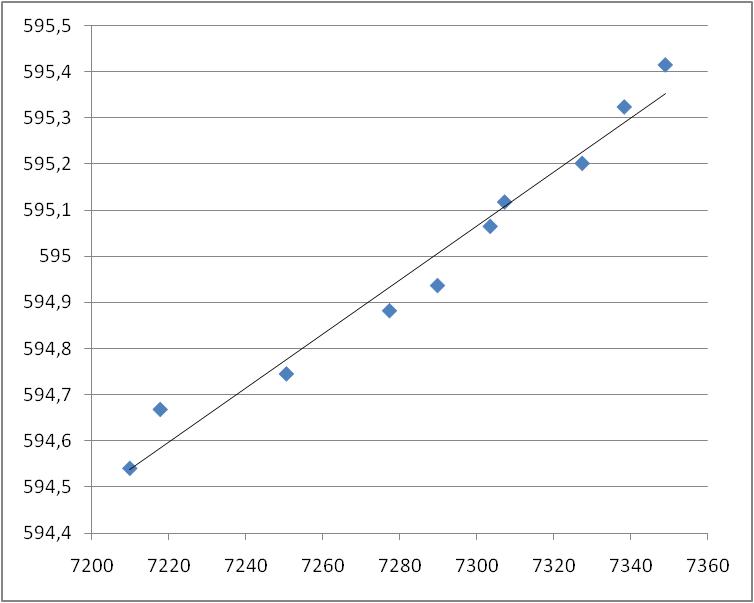

I found out that there is a strong relationship between the battery level and gyro offset. When battery power drops, the gyro offset drops as well.
Below is a graph of the relationship. In mathematical terms the relationship is: offset= 0.004981 * mVolt + 558.7103. In plain english this means that if the battery power drops with 0.2 volt the offset off the gyro will drop with 1 degree. In some cases this is enough to make corrections usefull.
Some words about the experiment. I used a stationary NXT with a Gyro and two (port A and C) free running motors attached. During 4 minutes samples were taken of the gyro, motor power and battery level. A sample was taken every 5 mSec. I ended up with 34649 data points (some points were lost due to blue tooth). During this time different levels of (uncontrolled) motor power were applied to both of the motors. The motor power levels ranged from -100 to 100 in steps of 10. Every ten seconds a new power level was selected.
A disclaimer:
There is not only a strong relationship with battery level and offset but also with motor power and offset. This is obvious as the motors cause the power drop in the first place. So why am I so sure that the power drop is the cause of offset drop, and not the motor power? Well, to be fair, I am not sure at all. One needs another experiment to find out.
Another disclaimer:
I have assumed the relationship between power and offset is lineair. I do not know if that is true for the full power range.
