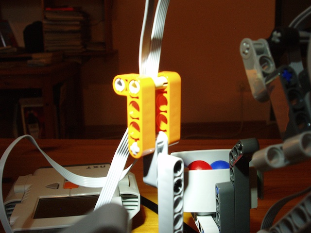

As you probably noticed, I also modified the cable guide. The Flexi-cables from mindsensors.com needed a bit more support than the orginal Lego cables.

Thanks for the extra photos. They make the changes to the chute very clear. As you say the track is very critical, both in getting the spacing between the rails right and the positioning of the bottom stop, so that the next ball ends in precisely the right position to be grabbed. I look forward to trying out your mods when I get back to the model next week.

I finally rebuilt Stonehenge, adding most of the improvements shown in your previous photos. It does improve reliability of my NXT-G code (I just had to change an angle constant in gripper code). The only problem I had is that the flexicables get entangled in 7-beam you added to the arm (probably my home-made flexicables are not the same length as yours), I changed it to a 5-beam.
